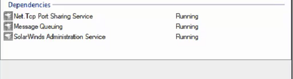

RabbitMQ is installed but the service is missing in SolarWinds Platform Service Manager:
Network Performance Monitor
RabbitMQ service was already registered in the Erlang registry but will have to update the service parameters.
