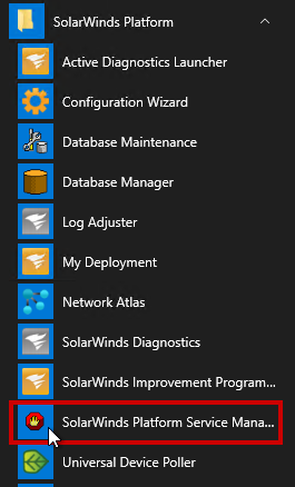

  1. On the Primary Polling Engine, open the "SolarWinds Platform Services Manager", AKA "Orion Service Manager" located by clicking on the Windows Start button > SolarWinds Platform > SolarWinds Platform Service Manager

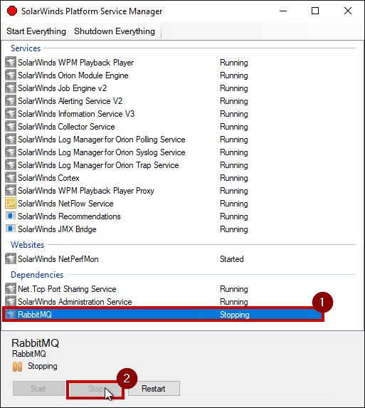

  2. Stop the RabbitMQ service.
