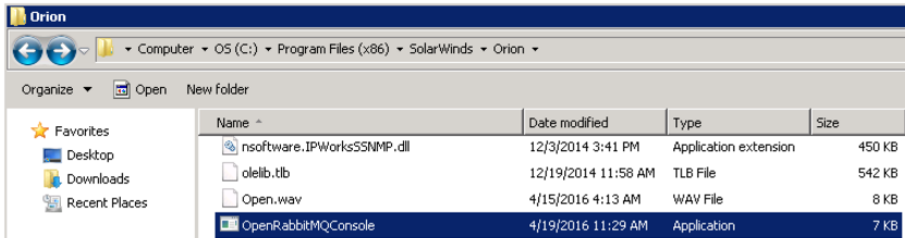

You can view the message queues by using the RabbitMQ Management Console. RabbitMQ itself serves this simple website (IIS is not involved).
On the main polling engine, navigate to the installation directory (C:\Program Files (x86)\SolarWinds\Orion by default) and find OpenRabbitMQConsole.exe.
(Screenshot property of © 2020 Microsoft)

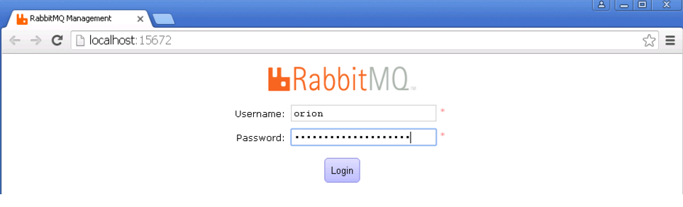

This will read the RabbitMQ password from the Orion database, decrypt it, and copy it to the clipboard, and then open the system default browser to http://localhost:15672
Log in with username "orion" and paste in the password to visit the RabbitMQ management console. By configuration, this console is not accessible remotely - only on localhost.
  • Openrabbitmqconsole.exe fetches it from the database, decrypts it, then copies it to the clipboard and opens the browser.
  • Then you must type "orion" into the username box and hit paste/ctrl+v in the password box.
(Screenshot property of © 2020 VMware)
NOTE: The username is case-sensitive. Only "orion" will work.

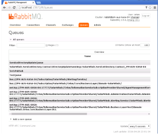

The number of messages in the "ready" state on the Queues tab should stay at zero. If one of these numbers is hanging out above zero, some process needs to receive its messages properly. Orion components use the "SwisPubSub" queue to send published pubsub messages. SWISv3 on the main polling engine reads this queue and forwards messages to subscribers. Other queues are used by subscribers to receive notifications delivered by SWIS.
Not all pubsub subscribers have been updated to use RabbitMQ in this release. You can see which subscriptions are using RabbitMQ by looking in the Subscriptions table in the database. Rows where the Binding is "MessageBus" are using RabbitMQ. The EndpointAddress column holds the queue name for these subscriptions, even if it looks like a WCF Uri.
