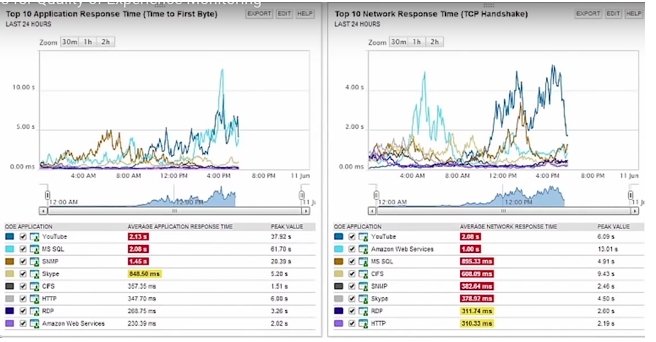

How does QoE work? - Quality of Experience (QoE) is a new dashboard within NPM that allows you to monitor traffic on your network. QoE uses Packet Analysis Sensor to provide packet- level traffic information about key devices and applications that you specify

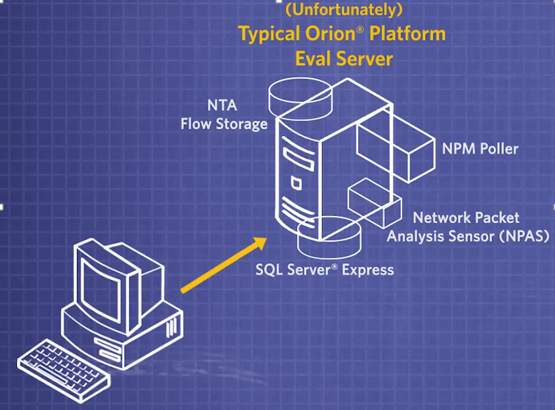

QoE was introduce in NPM 11 and its part of the install.
You can install sensors in Windows server (Server sensor and Network Sensor).

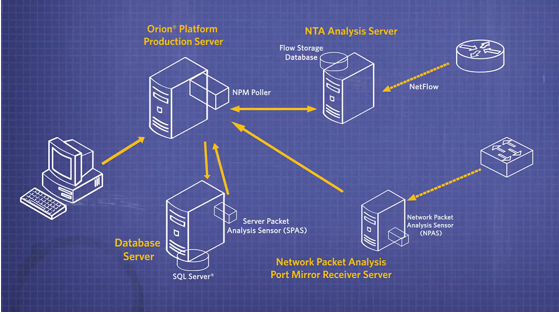

This is Packet Sniffing build into the Core of NPM.

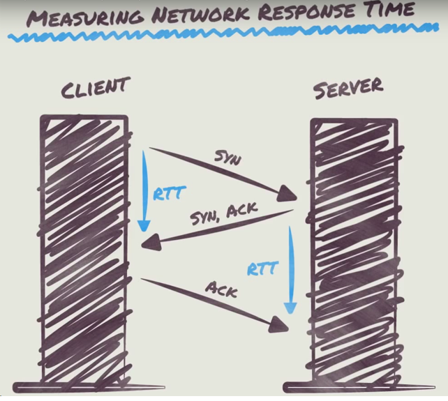

How does QoE Work?
QoE uses Packet Analysis Sensor to provide packet- level traffic information about key devices and applications that you specify.

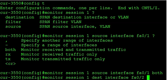

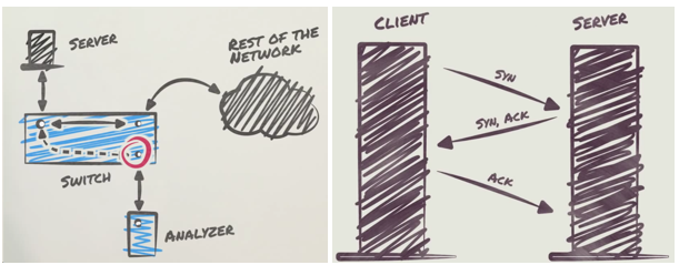

We are going to Span or mirror FastEthernet0/1 OVER FastEthernet0/2.
You can also Span or mirror Vlan1 OVER FastEthernet0/2.
Realistically you will not SPAN ports and VLANS simultaneously – You usually do one or the other.
Commands:
You can pick any number you want.
Source is FastEthernet0/1
Both means – do you want Input or Output (in this case BOTH).
Destination is (where is it going to?) FastEthernet0/2
Go into Config mode --- config t
Exit
Write mem
Congrats you have just setup a SPAN port

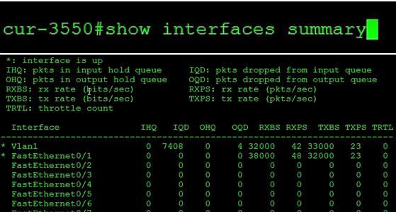

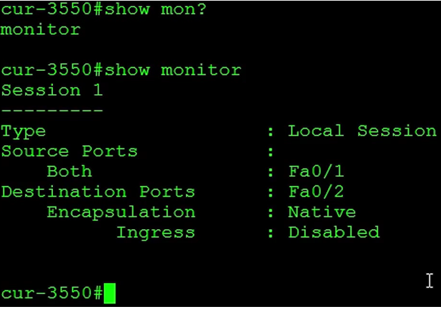

How do you see what you already have as SPAN?
So you can see what is going on there.

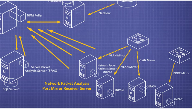

What happens if you have a dozen ports? … this takes us into the VLANS
VLANS only have received so we need to say “rx” to set up VLAN SPAN

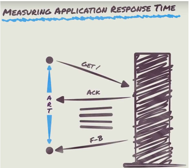

Slow – is it the wire (network or the application?  DPI is here

Is it the Network or is it the Application?
