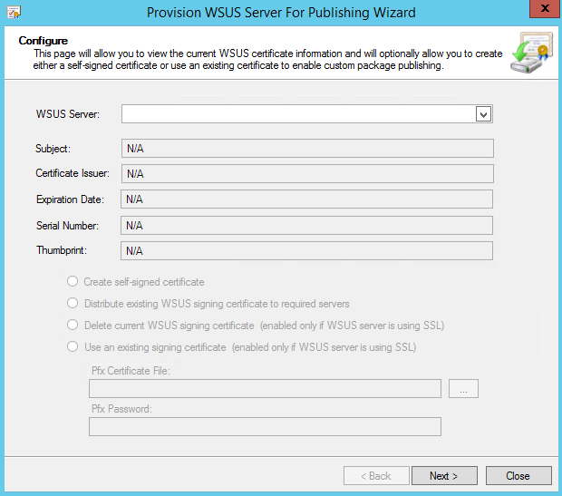

Solution 1: Run the Provision WSUS Server for Publishing Wizard
This procedure creates or distributes the certificate needed for publishing.
  1. Log in to the Patch Manager Administrator Console as an administrator.
  2. Expand Administration and Reporting and select Software Publishing.
  3. In the Actions pane, click Server Publishing Setup Wizard.
  4. In the wizard, click the WSUS Server drop-down menu and select your WSUS server.
  5. Complete the remaining fields, and click Next.
  6. Complete the wizard.
