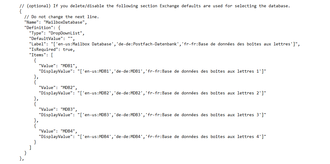

  • The Exchange database specified in the customized template could not be found in Exchange.
  • Maybe the database is not mounted or the list in the template is not updated.
  • It can be also that different customized settings in the Exchange Module of the template can cause this problem by conflicting with the Exchange configuration.
  • Try to use the standard Exchange module in the Create New User template as shown in the article below. If it works fine please check the customized sections. An idea of what the problem can be is listed below.
  • https://documentation.solarwinds.com/en/success_center/arm/content/create-an-exchange-mailbox.htm
  • Remove the related code section from the template as described below, so that Exchange chooses a database automatically, or update the list with the available databases.
