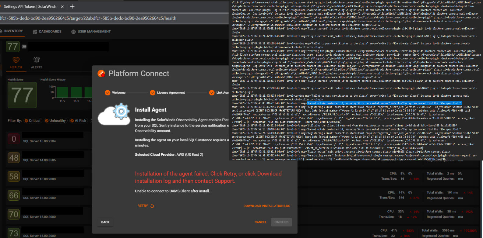

When attempting to use a system that previously had Platform Connect set up, the new installation may fail with a generic "Installation of the agent failed" error.
12/5/2025 4:00 PM
12/5/2025 4:00 PM
The following error messaging can be seen in the uamsclient log when a new agent installation fails on an environment with a previous Platform Connect installation.
Installation of the agent failed. Click Retry, or click Download installation log and then contact Support.
