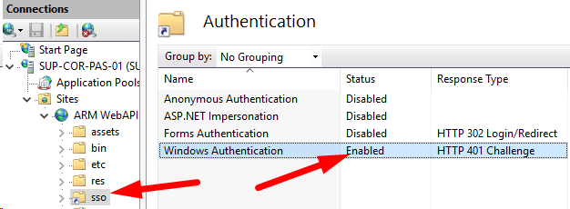

1. Enable Windows Authentication for SSO on the Grant MA page (relevant only for ARM 2019.4 and 2020.2).

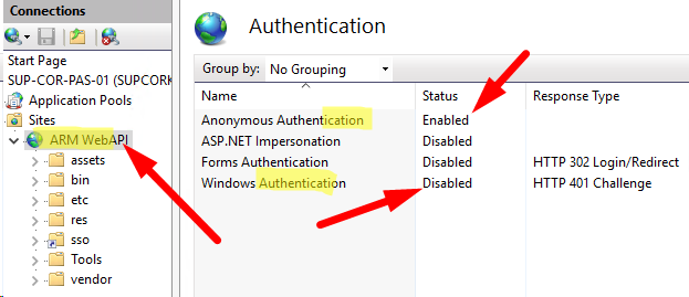

2. On the Grant MA page, deactivate Windows Authentication and activate Anonymous Authentication. (relevant only for ARM 2019.4 and 2020.2)

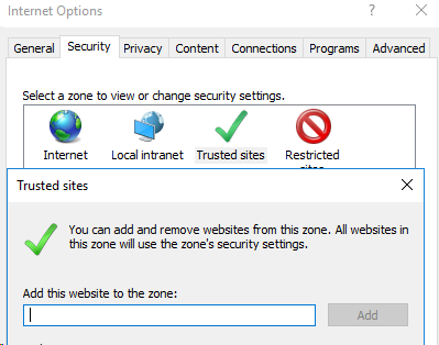

1. In your web browser, go to Internet Options and add the page to Trusted sites.

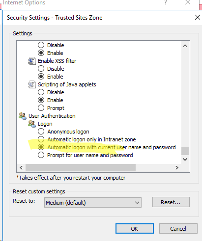

2. Adjust the level so that the user can automatically log in with the current username and password.
With these settings, you can now use SSO with Microsoft Edge and Google Chrome.

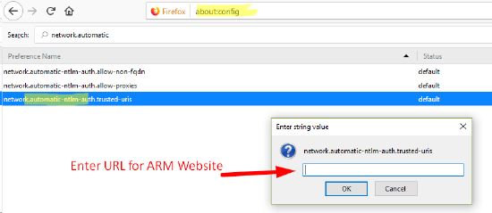

In Firefox, there is an additional setting required, which you can adjust at your own risk:
1. In the URL address bar, enter: about:config
2. Search for network.automatic-ntlm-auth.trusted-urls
3. Enter the address for your web application.
With this configuration added, you can now also use Firefox with SSO.
