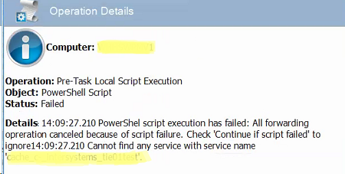

Scenario 1:
You are trying to use the new Feature in PM 2.1.6 i.e execute powershell script pre- or post-install tasks.
For example: You configured an update management task and selected the powershell script that will stop a windows service before the patches are applied. However the task fails with below error:

Solution for each scenario
- Scenario 1 -> Restart the Eminentware Data Grid Service.
