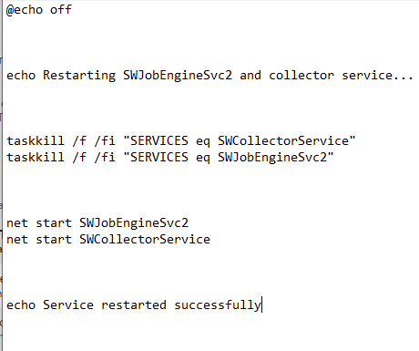

2. Open Notepad and paste the following:
@echo off echo Restarting SWJobEngineSvc2 and collector service... taskkill /f /fi "SERVICES eq SWCollectorService" taskkill /f /fi "SERVICES eq SWJobEngineSvc2" net start SWJobEngineSvc2 net start SWCollectorService echo Service restarted successfully
3. When saving it, choose all files and name it restart_SWJobEngineSvc2.bat

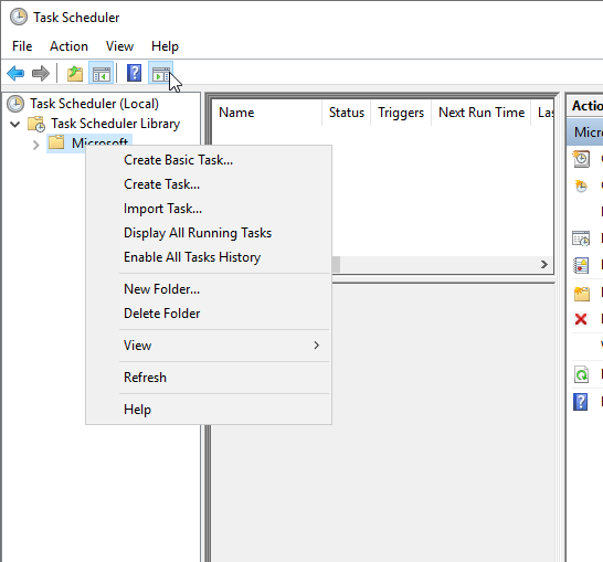

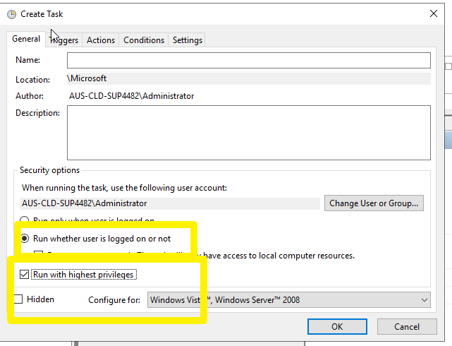

4. Open Task Scheduler and create a Task under Microsoft:
5. Set a name for the task and select "Run whether user is logged on or not and run with highest privileges:

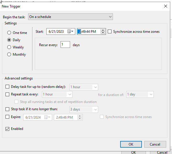

6. On the trigger tab set a daily schedule:

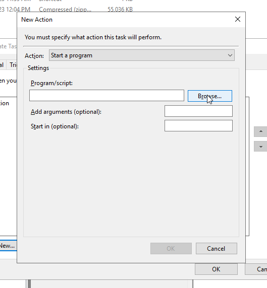

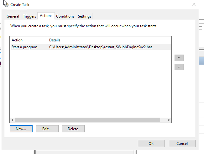

7. on the Action tab, select Browse:

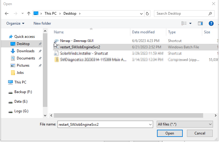

locate the batch file you saved and then select Open:

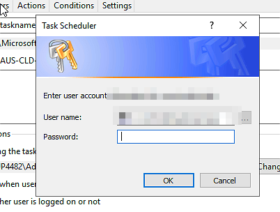

8. Click the OK button and enter a credentials that can run batch files:
