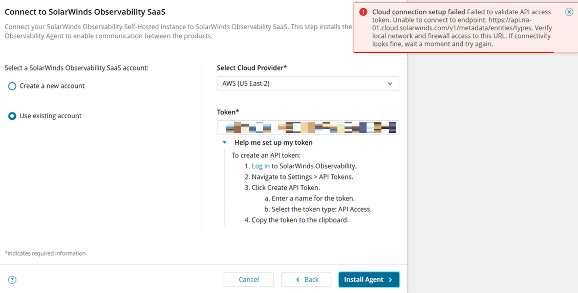

Platform Connect setup failed with "Cloud connection setup failed"
Cloud connection setup failed Failed to validate API access token. Unable to connect to endpoint: https://api.na-01.cloud.solarwinds.com/v1/metadata/entities/types. Verify local network and firewall access to this URL. If connectivity is successful, then try again. The URL "api.na-01.cloud.solarwinds.com" will vary depending on the region it communicates with.

Error from the Web Console
Core.Businesslayer.log shows the following sets of error message.
  1. 2026-06-02 02:13:14,593 [7] INFO SolarWinds.Orion.Core.BusinessLayer.CoreBusinessLayerService - (null) Starting Platform Connect flow with existing token.
    2026-06-02 02:13:14,597 [7] INFO SolarWinds.Orion.Core.BusinessLayer.PlatformConnect.Orchestrator - (null) Step: Checking current UAMS installation status.
    2026-06-02 02:13:14,603 [7] INFO SolarWinds.Orion.Core.BusinessLayer.PlatformConnect.Orchestrator - (null) Step: Validating API access token.
    2026-06-02 02:13:14,603 [7] INFO SolarWinds.Orion.Core.BusinessLayer.PlatformConnect.SwokenValidator - (null) API access token validation request details - Method: GET, Endpoint: https://api.na-01.cloud.solarwinds.com/v1/metadata/entities/types, Token: lgYh*************-*************************************************qH8g, Timeout: 00:00:20

    2026-06-02 02:13:14,651 [7] WARN SolarWinds.Orion.Core.BusinessLayer.PlatformConnect.SwokenValidator - (null) API access token validation returned non-successful status - StatusCode: 0, ResponseStatus: Error, ErrorException: An error occurred while sending the request.
    2026-06-02 02:13:14,653 [7] ERROR SolarWinds.Orion.Core.BusinessLayer.CoreBusinessLayerService - (null) Unexpected error in StartConnectWithTokenInternal.
    System.InvalidOperationException: Failed to validate API access token. Unable to connect to endpoint: https://api.na-01.cloud.solarwinds.com/v1/metadata/entities/types Please verify the network/firewall allows access to this endpoint. Error: An error occurred while sending the request.
