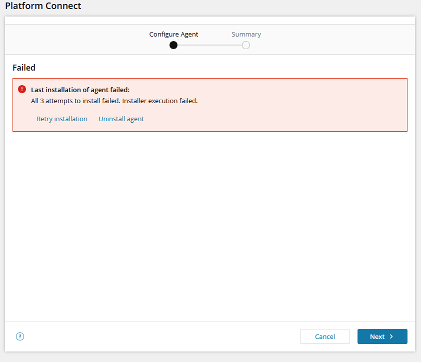

In the Platform Connect Wizard, after typing the API Token to deploy the Agent, it gets the following error:

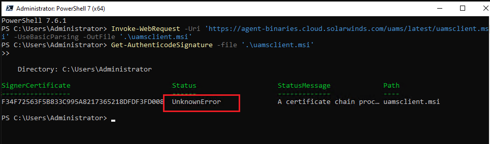

You can test by running the following PowerShell commands:
1- Invoke-WebRequest -Uri 'https://agent-binaries.cloud.solarwinds.com/uams/latest/uamsclient.msi' -UseBasicParsing -OutFile '.\uamsclient.msi'
2- Get-AuthenticodeSignature -File '.\uamsclient.msi'

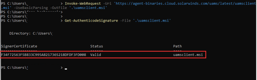

It should appear a Valid result.
If it appears UnknownError in Status like below, Windows is not updating the CA certificate.
It is necessary to allow the "Automatic Root Certificates Update" on the Main poller side.
