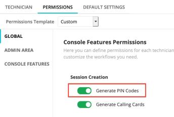

The first step is to make sure that the technicians have the appropriate/correct permissions configured.
  1. Navigate to Management > Technicians and select a technician from the list.
  2. Click the Permissions tab and make sure Generate PIN Codes is selected.
  3. Click Save to apply the changes to the technician.
NOTE: If you do not wish to use PIN CODE, you may turn off the permission to "Generate Pin Code".

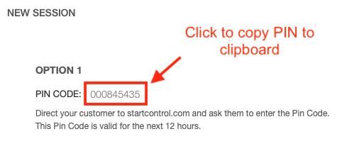

Generate a PIN Code
  1. In the home tab of your console, select Start New Session.
  2. Click the 9-digit PIN code to copy it to the clipboard.
  3. Share the PIN Code with the customer.
    1. Email the code to your customer.
    2. Direct them to startcontrol.com to enter the code.
The customer/user can use the PIN code to download the applet and request a support session. A technician will then accept the request to start the support session and provide assistance to the customer.
