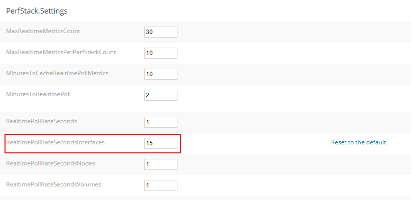

    http://Hostname/Orion/Admin/Advancedconfiguration/Global.aspx
  3. In PerfStack.Settings, change RealtimePollRateSecondsInterfaces to 15 or more (assuming it is an interface poller).
  4. Save.
  5. Restart all SolarWinds Services on all pollers with the SolarWinds Platform Service Manager. Note: If HA has been configured in your environment, please disable High Availability pool before restarting the services to prevent failover.
