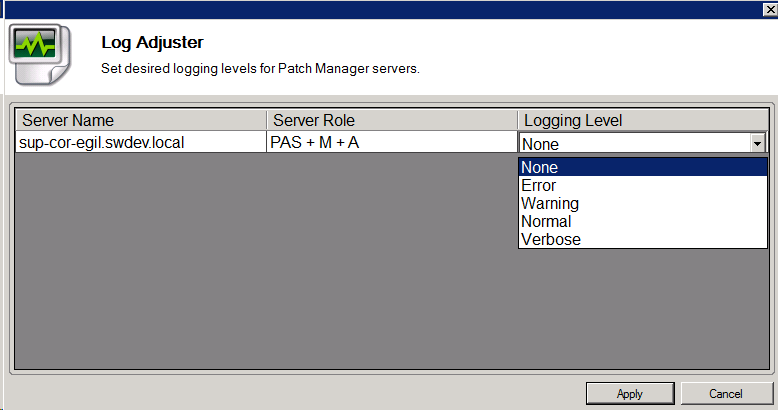

At this point you have should have an error message either through the GUI or in the logs. If there are no errors or events in your logs confirm you have identified the correct issue and the correct logs. Increase the logging level if you are sure you have identified the core issue, not just a symptom of the issue and that you are checking the correct logs.

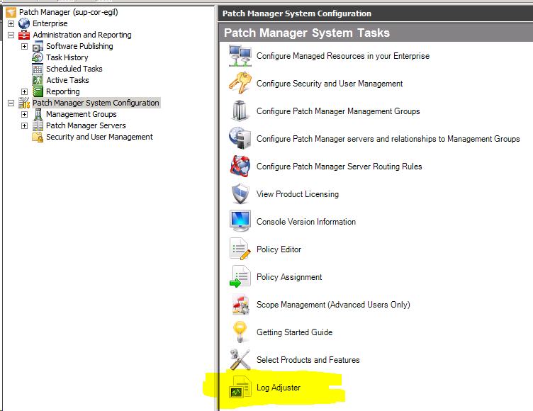

To increase the log level see the below or use the Patch Manager Log Adjuster. The Log Adjuster is accessibly through the MMC console by selecting "Patch Manager->Patch Manager System Configuration" and in the middle pane select "Log Adjuster"
