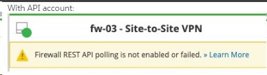

"Firewall REST API polling is not enabled or failed" for Palo Alto Site-to-Site VPN when incorrect permissions are configured
This article explains how to fix the issue when Palo Alto site-to-site VPN fails with "Type [xx] not authorized for user role." or "Forbidden 403". Within the SolarWinds Platform, you may receive the error message "Firewall REST API polling is not enabled or failed"
Firewall REST API polling is not enabled or failed.

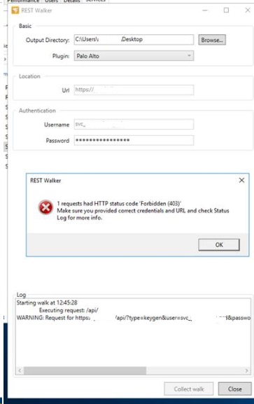

In Cortex or Collector log, the following error message may appear:
ERROR SolarWinds.CortexPlugin.NetMan.Firewalls.Internal.Handlers.Statistics.Handlers.FirewallStatisticsResultHandler - Discovery for result type FirewallStatisticsResult for element FirewallElement:1806 failed with exception [System.AggregateException: One or more errors occurred. ---> System.AggregateException: One or more errors occurred. ---> System.Net.Http.HttpRequestException: Forbidden - Forbidden. Details: <response status = 'error' code = '403'><result><msg>Type [op] not authorized for user role.</msg></result></response>If you execute the REST Walker, you can see the same 403 error:

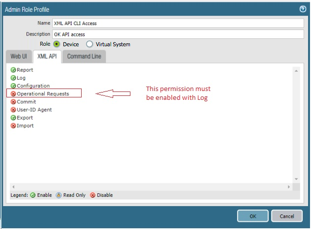

This issue occurs when the account configured in Edit Node does not have permission to pull site-to-site VPN details.
To resolve this problem, please configure the following permissions for the associated Admin user. In Palo Alto account configuration (XML API Admin Role Profile)
- Read Logs
- Operational Requests
