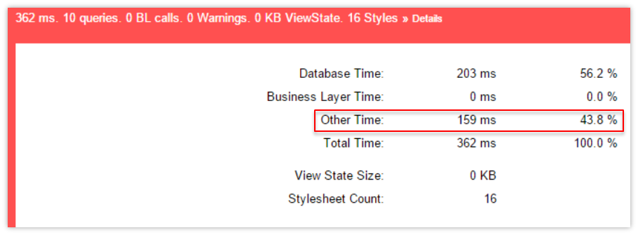

  • If Other time is quick, then the problem lies elsewhere:
In the example above, 159 ms for Other time is clearly not an issue

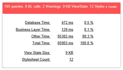

Proof Positive
  • If in like the example below, Other time is high at over 85 seconds, the things that contribute to Other time is what you want to focus on
  • High response times here may indicate old cache data or slow SWIS response time
  • Check Orion.InformationService.log for long running queries
  • Look for errors in Orion.InformationService.log
  • Check for communication issues with other polling engines
