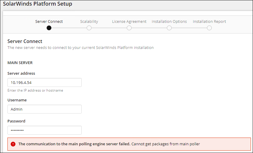

When you run the SolarWinds Platform installer on scalability engine, you might see the following error in the installer GUI, which ends the installation or upgrade attempt:
The communication to the main polling engine server failed. Cannot get packages from main poller.
