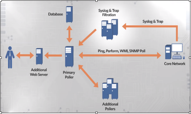

3. Filtering the Syslogs and Traps between the sending device and Orion
This approach would utilize other SolarWinds products, such as Log and Event Manager (LEM) or Kiwi Syslog to receive the Syslog and Trap messages sent from your devices, and using these products to filter only the most important Syslog or Trap messages and then forwarding only those message to Orion. This approach shows more benefit as your deployment scales to monitor larger networks.
