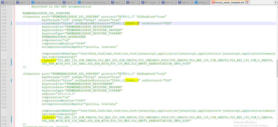

Workaround 2
Disable TLS 1.3 in the wrapper_server_template.xml file
1) Stop Webhelpdesk.
2) Go To C:\Program Files\WebHelpDesk\conf and open the tomcat_server_template.xml file in Notepad.
3) Remove TLSv1.3 from lines 106 and 121.
4) Replace the below value of ciphers from Line no. 115 and 131
ciphers="TLS_RSA_WITH_AES_128_CBC_SHA256,TLS_RSA_WITH_AES_256_CBC_SHA256,TLS_RSA_WITH_AES_256_CBC_SHA,TLS_RSA_WITH_AES_128_CBC_SHA,SSL_RSA_WITH_3DES_EDE_CBC_SHA,SSL_RSA_WITH_RC4_128_SHA1,SSL_RSA_WITH_RC4_128_MD5,TLS_EMPTY_RENEGOTIATION_INFO_SCSV"
5) Start the Web Help Desk.
6) Check if the tickets are now created from the SolarWinds Platform alert
