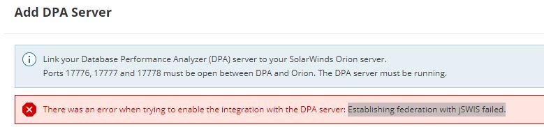

There was an error when trying to enable the integration with the DPA server: Establishing federation with jSWIS failed.
This article explains how to fix the error: There was an error when trying to enable the integration with the DPA server: Establishing federation with jSWIS failed.
When trying to perform web console integration of Solarwinds Platform and DPA, the following error message may appear:.
In DPAIM logs:
2020-09-28 13:11:26,793 [81] ERROR SolarWinds.DPA.BusinessLayer.Integration.Commands.ConfigureIntegration.EnableFederationCommand - Information schema refresh timeout (30 seconds) exceeded

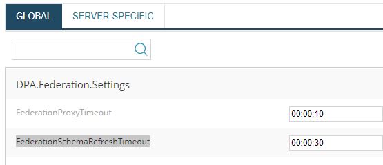

1. Point your browser to /Orion/Admin/AdvancedConfiguration/Global.aspx
2. Find & Change the following setting
"FederationSchemaRefreshTimeout" and change it to something much larger - like 10 or 15 minutes
Schema refresh appears to be the last part of the integration process and as it timeouts, all other parts are rollbacked.
3. Restart services and try to integrate again.
