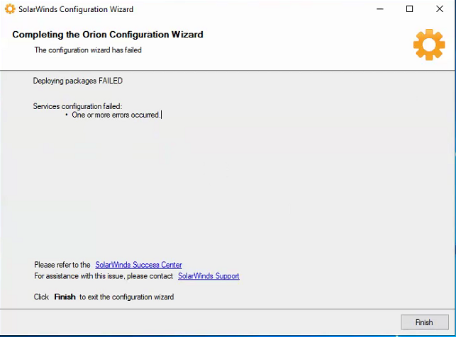

Running the Orion Configuration Wizard getting a failure below:
Sample Image:
