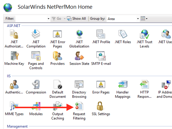

  5. Open Internet Information Services (IIS) Manager
  6. From the left pane, select the SolarWinds website
  7. Under IIS section, select Request Filtering
(Screenshots property of © 2021 Microsoft Corporation. All rights reserved.)

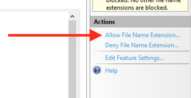

  1. From the right pane, select Allow File Name Extensions

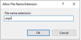

  1. Enter .aspx
  2. Click OK
