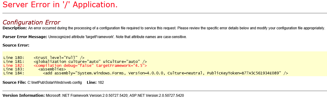

The following error is displayed when logging in to the Orion Web Console:
Server Error in '/' Application
Configuration Error
Description: An error occurred during the processing of a configuration file required to service this request. Please review the specific error details below and modify your configuration file appropriately.
Parser Error Message: Unrecognized attribute 'targetFramework'. Note that attribute names are case-sensitive.
Network Performance Monitor
Environment
NPM versions using .NET Framework 4.0 or later
The IIS application pool for the SolarWinds website is set to use .NET 2.0 while web.config is configured to use .NET 4.0. by default.
  1. In IIS Manager, change the default application pool settings for the SolarWinds website to use .NET 4.0
  2. Restart the application pool and website.
