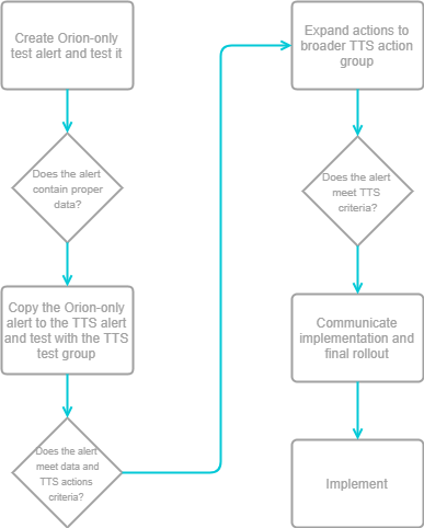

Example test flow
The final test plan should include the following elements:
  • The purpose of initial alert(s) to be created and tested.
  • Orion Platform-only initial alert test targets.
  • Criteria for success in initial Orion Platform-only alerts.
  • Migration of Orion Platform-only initial test alert to TTS test group only.
  • Criteria for success of integration TTS test alert and action(s) to test group. Expansion of TTS test alert actions to broader parties.
  • Criteria for acceptance of broader test.
  • Final decision to implement first TTS alert and associated communications.
  • Requirements for the rollout of subsequent TTS alerts and actions.
The following is an example of a test plan flow.
When testing alerts, copy alerts and save them under a new name. Make sure you rename and enable the new copy and disable alerts that are no longer used. You can either retain both an Orion Platform-only alert for a small group and the TTS-enabled alert for a broader audience to keep a backup system to notify critical parties of network outages should TTS problems occur.
See Test alert triggers and actions
