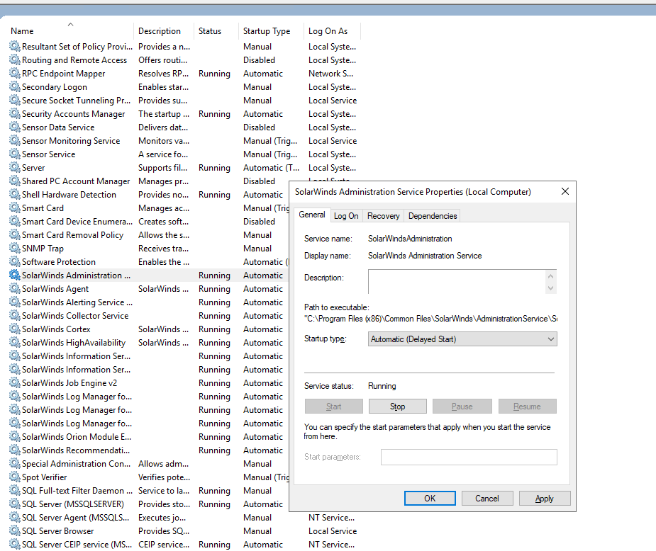

Set all SolarWinds services Startup type to: "Automatic (Delayed Start)" using the Windows Services MMC.
See the following screenshot for an example:
Please make sure that you update all the SolarWinds services to Automatic Delayed Start for best results.
