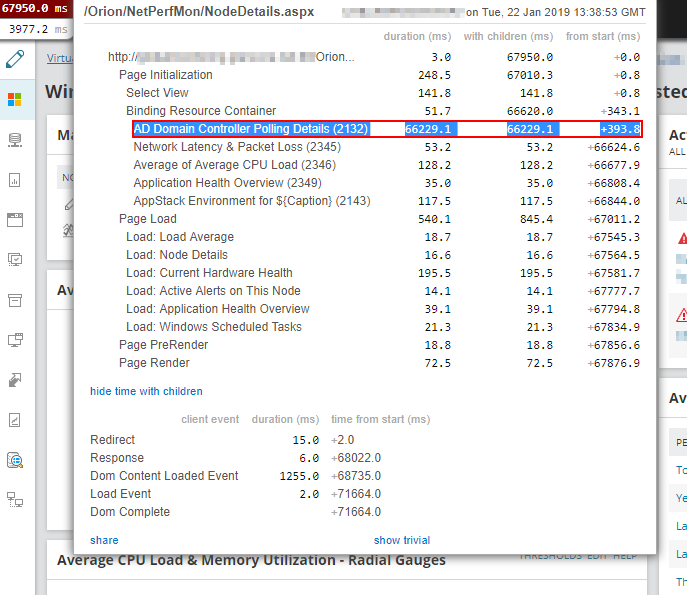

The Node Details page is slow to load.
The investigation using Hubble shows that the AD Domain Controller Polling Details resource is taking over 60 seconds to load.
See this guide to using Hubble: Turn on and use Hubble with Orion modules.
A screenshot from Hubble is below:
  • Remove the AD Domain Controller Polling Details resource from the view as it is not required since the user is not polling AD DCs using UDT.
  • How to remove AD Domain Controller Polling Details resource
  1. Navigate to the Node Details view where you see the issue.
  2. Click on the pencil in the top left to customize the page
  1. Locate the resource and click on the 'X' symbol
  1. Click Remove
  1. Once the resource is removed you can click on 'DONE EDITING' in the top right of the page.
