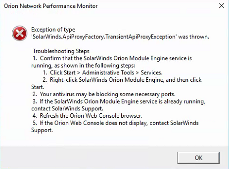

Launching the Orion Web Console being prompted with an error below:
