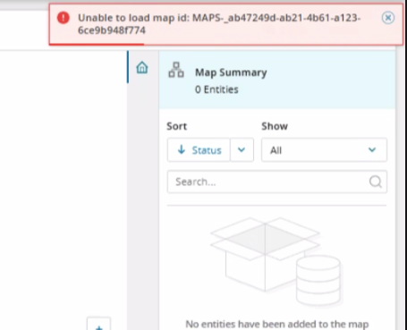

After upgrading to SolarWinds Platform 2025.1.1, maps does not load properly and produce the following error message:
Unable to load map id: MAPS-_XXXX
When accessing the view with the Map, it shows an error, which can be seen in the IIS log.
2025-05-08 22:43:06 GET /api2/maps/v1/projects/MAPS-_XXXX-XX-401d-9237-b1d2d9ad7e50/ - 443  Mozilla/5.0+(Windows+NT+10.0;+Win64;+x64)+AppleWebKit/537.36+(KHTML,+like+Gecko)+Chrome/136.0.0.0+Safari/537.36  https://URL/apps/maps/viewer/MAPS-_XXX-XX-401d-9237-b1d2d9ad7e50 404 0 0 658
Orion Platform
This issue occurs due to the underscore symbol ( _ ) in the maps url when display in the modern dashboard.  This issue is only applicable to SolarWinds Platform 2025.1 and 2025.1.1.
To resolve this issue, please upgrade to SolarWinds Platform 2025.2 and above.  If any upgrade is not possible, please apply the workaround below by performing the following steps:
  • Remove the Map from the view and re-add it.  This will create the map url without the underscore.
  • If you created a link in the Menu bar, you will need to update the Map URL with the underscore symbol.
