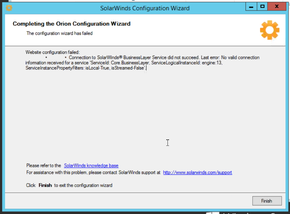

You may find an additional polling engine is failing during the configuration wizard with the following error:
1	No valid connection information received for a service 'ServiceId: Core.BusinessLayer,
2	ServiceLogicalInstanceId: engine:13, ServiceInstancePropertyFilters: isLocal-True,
3	isStreamed-False'.

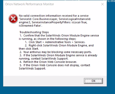

Example 1:
Example 2:

When adding nodes to the additional polling engine, you may see the following message in the webserver Orionweb.log.
