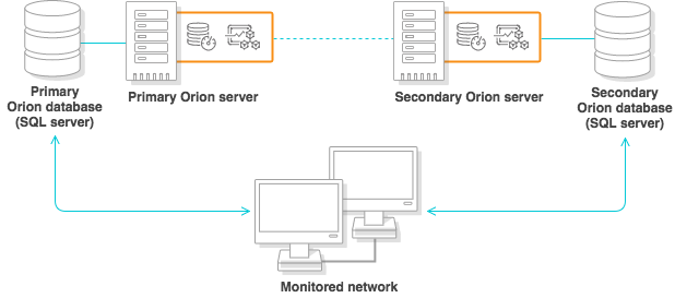

A completed SolarWinds Platform Active/Active installation provides you with a full duplicate of your existing SolarWinds environment for disaster recovery purposes.
Deploy the Active/Active solution to reduce the downtime caused by maintenance or upgrades.
The solution requires a special license. You need to regularly synchronize primary and secondary databases.

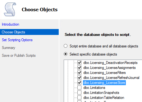

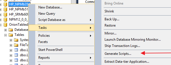

    1. In the SQL Management Studio, right-click the secondary database, and select Tasks > Generate Scripts.
    2. Select tables with the prefix dbo.Licensing_*.
    3. Complete the wizard. By default, the wizard generates only the schema, you don't need to modify anything. The script is created.

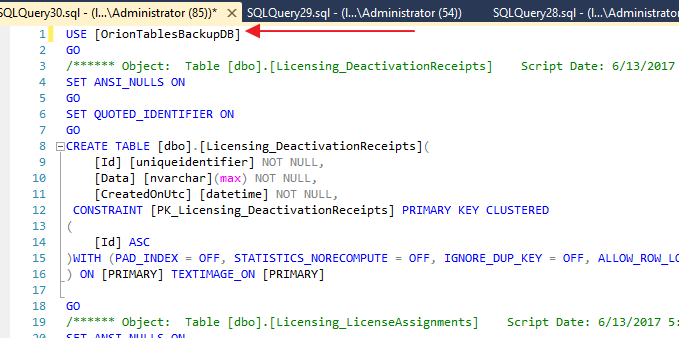

    4. Open the script, and modify the database name to the name of the database you created.
    5. Launch the script (F5) to create the tables.

You have now created the OrionTablesBackupDB database for backing up licensing data that must not be overwritten by the post-restore script. The licensing data stays in the backup database and the scripts you have set up copy the licensing data from the backup to the synchronized database.
