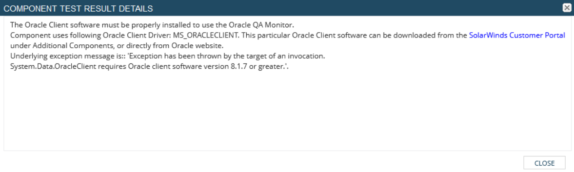

After the 2022.3 upgrade, the Oracle User Experience Monitor components are showing the following error message:
Exception has been thrown by the target of an invocation. ---> System.Exception: System.Data.OracleClient requires Oracle client software version 8.1.7 or greater.

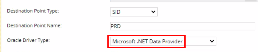

- Edit the Application Monitor that contains the Oracle User Experience Monitor and Select Microsoft.NET Data Provider for the Oracle Driver Type:
