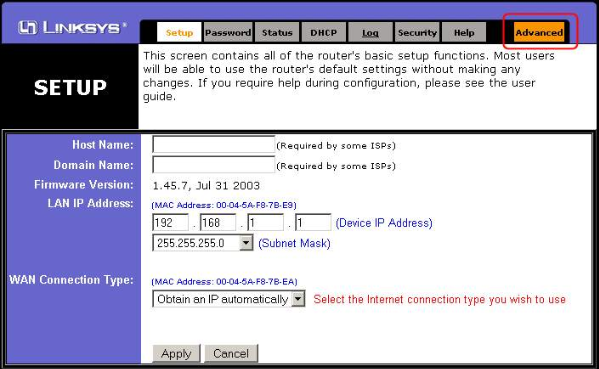

  3. From the router's main configuration screen, click Advanced as shown below:

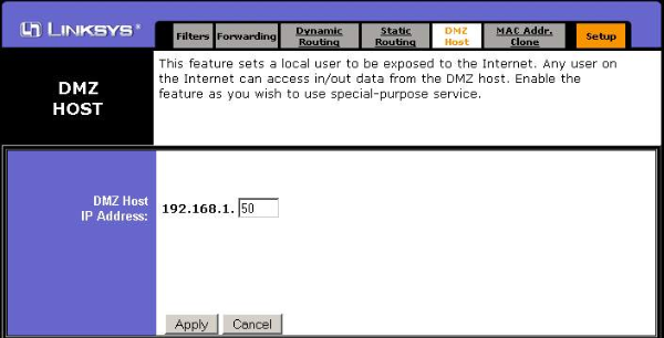

In the case that configuring individual port forwarding rules is not an option, most SOHO routers also include the option to place a single computer in a DMZ, or Demilitarized Zone, for the internal network. This causes all incoming requests to be routed to the computer in the DMZ. These include FTP/FTPS/SFTP/HTTP/HTTPS requests, but can potentially include harmful traffic from the internet as well. If the computer hosting Serv-U has known to be secure and is kept well-patched, navigating to the Advanced menu then the DMZ Host menu allows you to list a specific IP address on your network that will be the DMZ host and receive all unspecified incoming network traffic.
