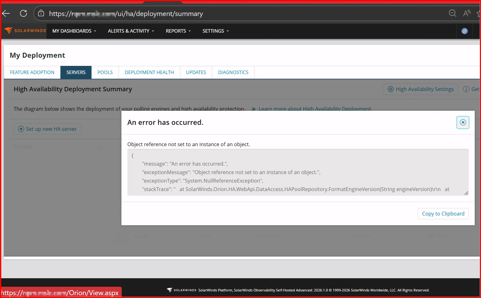

"Object reference not set to an instance of an object." message when accessing the Servers Tab in My Deployment page after upgrading to SolarWinds Platform 2025.2 or newer
You may experience an error when accessing the Servers Tab in My Deployment Page. The error points to "Object reference not set to an instance of an object." Unable to see the list of SolarWinds servers.
3/5/2026 7:24 PM
3/5/2026 7:24 PM
After upgrading to SolarWinds Platform 2025.2 or later, you cannot see the list of SolarWinds Servers under the Servers Tab on the My Deployment Page.
Error:
"message": "An error has occurred.",
  "exceptionMessage": "Object reference not set to an instance of an object.",
  "exceptionType": "System.NullReferenceException",
  "stackTrace": " at SolarWinds.Orion.HA.WebApi.DataAccess.HAPoolRepository.FormatEngineVersion(String engineVersion)\r\n at SolarWinds.Orion.HA.WebApi.DataAccess.HAPoolRepository.GetListOfOrionServers(Boolean isAllServers)\r\n

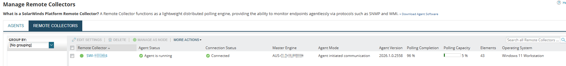

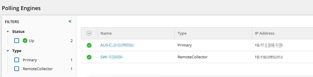

Identify if there are agents that are currently promoted as Remote Collector:
  • Check the Agent Management Page and see if there are agents that are promoted to Remote Collector
  • Check if that Remote Collector Polling engine exists in the Polling Engines page.
  • If the Agent/Remote Collector is not seen on the Polling Engines page, you need to remove and re-add the agent to switch it back to Agent-only configuration
