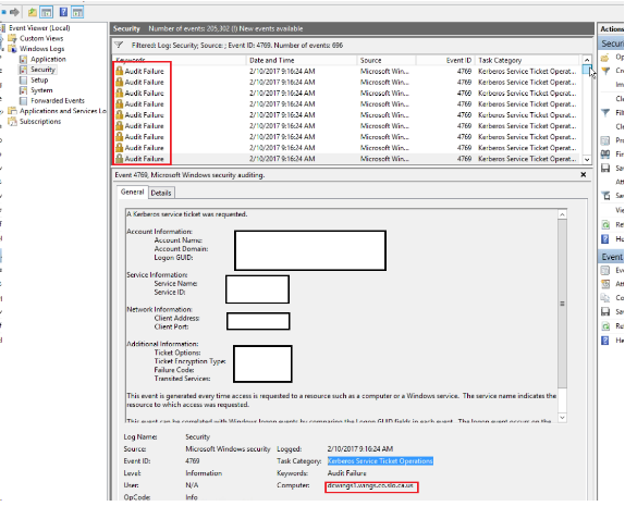

- The Event code is correct (4768, 4769 for Kerberos) but it shows Audit Failures in Event Logs as shown below. UDT only reads off Audit Success and not Audit Failure.

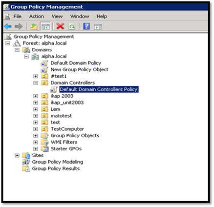

a. Go to Control Panel > Administrative Tools > Group Policy Management.
b. Navigate to the Default Domain Controllers Policy node, as shown below:
c. Right click Default Domain Controllers Policy and press the Edit menu.
d. Navigate to the Audit Policy node, as shown below:

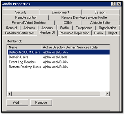

- Verify the non-administrator domain user is a member of the following groups:
- Distributed COM Users
- Domain Users
- Event Log Readers
- Remote Desktop Users (applicable only when the UDT server and the DC are on different domains)

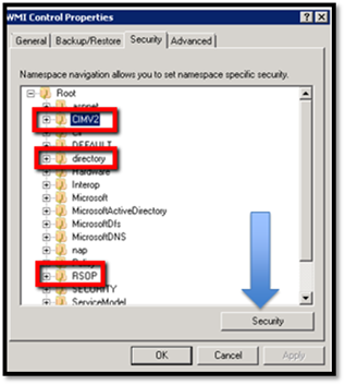

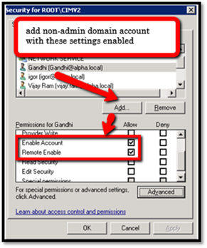

- Verify the non-administrator has access to the following WMI namespaces on both the Domain Controller and the Orion server. Refer to Use WMI Control to Manage Windows Management Instrumentation:
- CIMV2
- directory
- RSOP

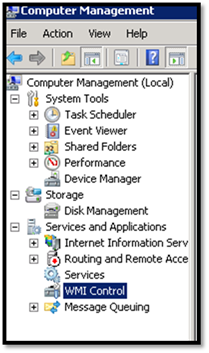

- To ensure this, go to Control Panel > Administrative Tools > Computer Management.
- Navigate to the WMI Control node as shown below:

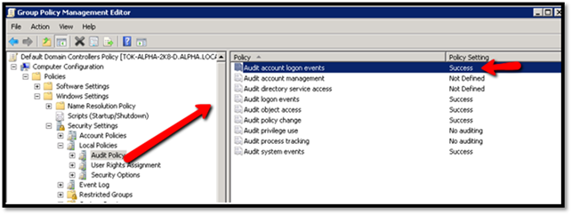

- Windows 2012 Run Group Policy Management Editor on the domain controller and go to the following node:
Computer Configuration > Policies > Windows Settings > Security Settings > Local Policies > Audit Policy - Expand the node to display a list of possible audit categories that can be configured.
- Verify that the following are enabled:
- Audit account logon events
- Audit logon events

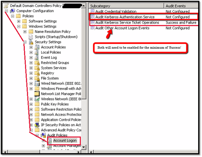

Note: In some environments, it may be necessary to configure Kerberos Authentication service:- Go to Security Settings > Advanced Audit Policy Configuration > Audit Policies > Account Logon.
- Verify that the two items containing Kerberos are defined.

- Define the following settings for R2 Domain Controllers using Advanced Audit Policy Configuration instead of Basic Audit Policy:
- Audit Kerberos Authentication Service: Define the policy and select both Success and Failure.
- Audit Kerberos Service Ticket Operations: Define the policy and select both Success and Failure.

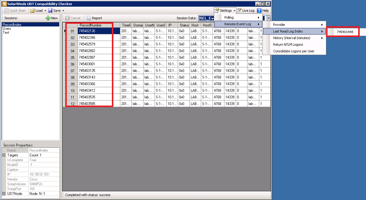

- If the information is valid (steps 1 through 8) perform the following steps:

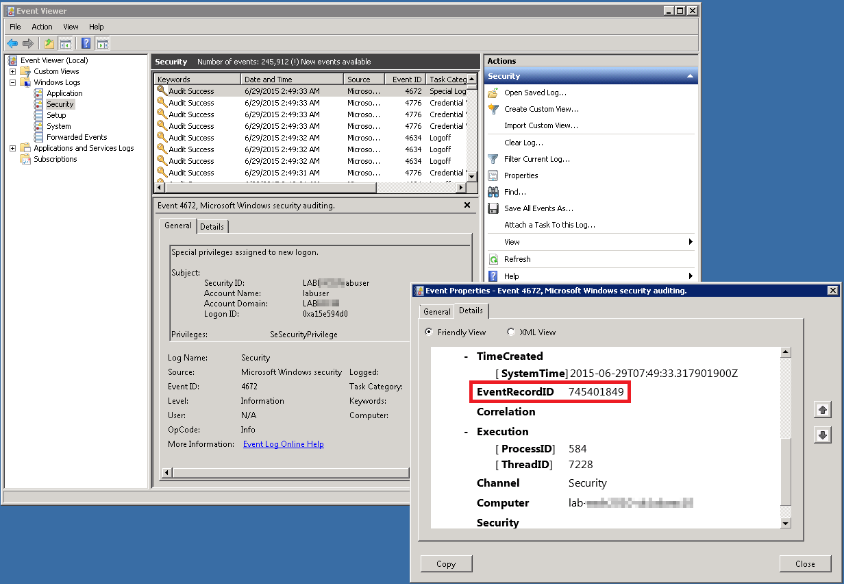

b. Open the Windows event log.
c. Click Event Properties in the right panel.
d. Select Details and expand the root System.
e. Look for the Event Record ID and copy it.
f. Subtract 1 from that value and place the index value into the compatibility checker.

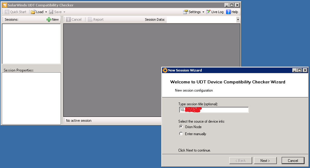

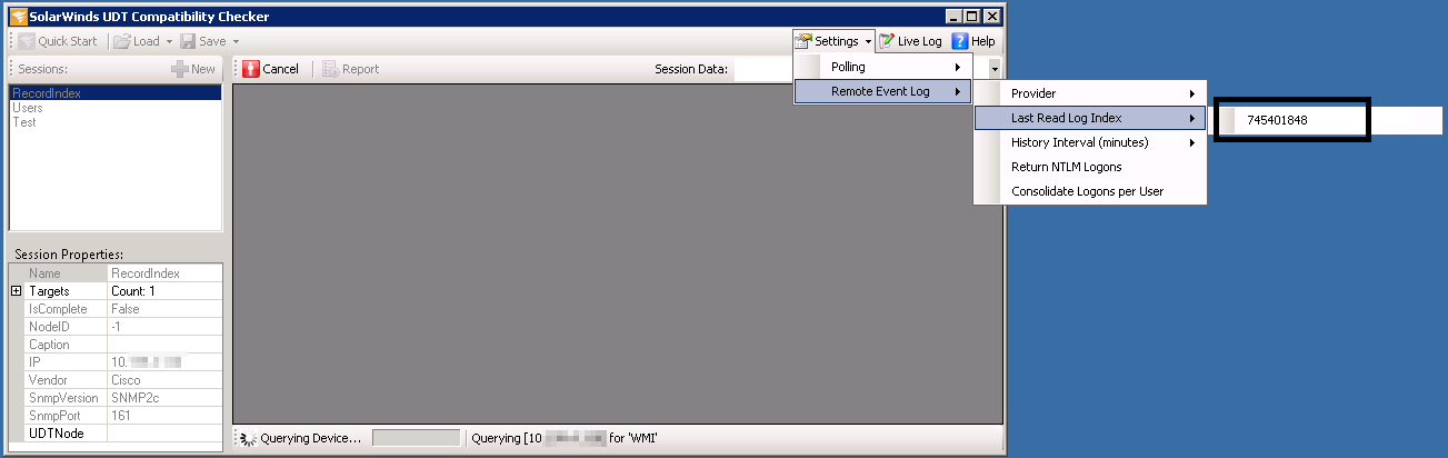

i. Open the compatibility checker (C:\Program Files(x86)\Solarwinds\Orion\UDT\UDT compatibility cheker.exe) and click Settings from the menu in the upper-right corner.
ii. Select Remote Event Log > Last Read Log Index > Edit and paste the Event Record ID.

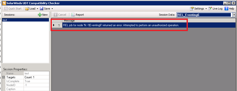

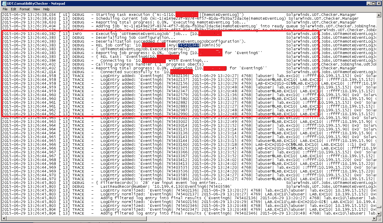

g. Start a new session for the AD DC Server. This reveals whether there are successful event logs for the DC.
You can see an event log record if available, after the last record index gets populated in the UDT CC.
You can also see the event log information in the UDT compatibility checker log file (C:\Program Data\Solarwinds\Logs\Orion).
If there are no event logs generated after the Last Index, you can see a message in UDT CC that there are no log entries to read.
