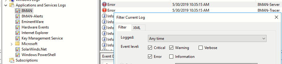

1. Access Application and Service Logs within the File Server as shown below:
2. Search for the following error: MiniTrcUserLib.MiniTrcUser:  MiniTrcUser::rulesParser attach : D: MINITRCUSER_ERROR_LOAD_MINITRCLIB within the above logs.
3. If the error is there, please download and install the following C++ Redistributable from here:
https://support.microsoft.com/en-us/help/4032938/update-for-visual-c-2013-redistributable-package
