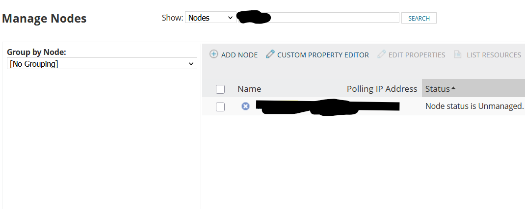

  • When searching for specific servers under Settings → Manage Nodes, only some of the expected nodes appear (or none at all).

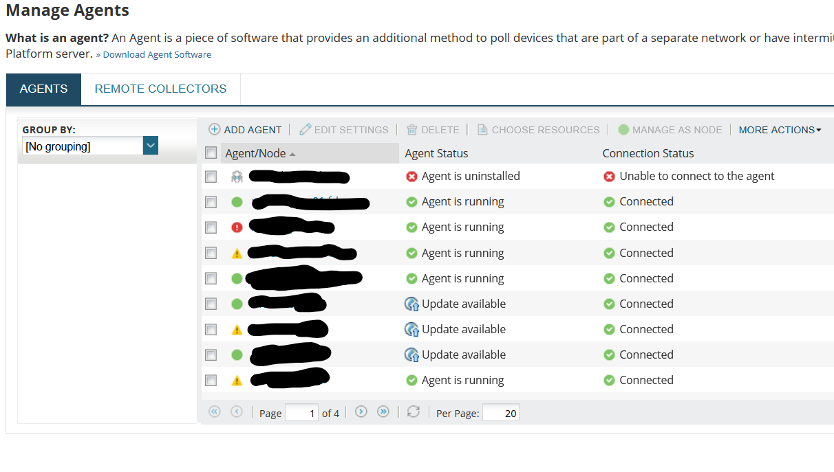

  • The same servers are present under Settings → Manage Agents, with:
    • Agent Status = Agent is running or Update available
    • Connection Status = Connected
  • You can still Unmanage / Mute from Manage Agents, but do not see the related node rows under Manage Nodes.

  1. Manage Nodes shows only a single node matching the search:
  1. Manage Agents shows multiple agent entries for the same servers:
