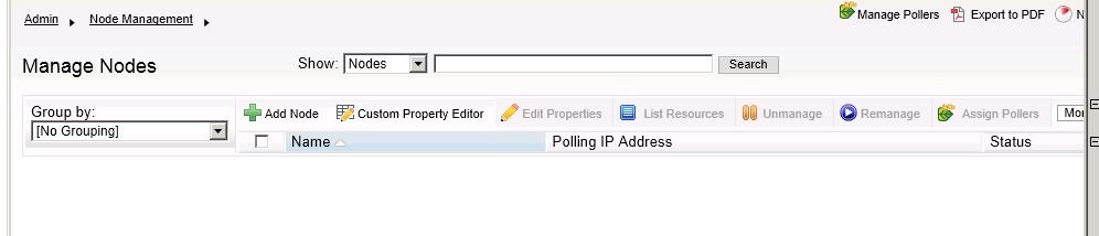

This article explains the behavior seen in Manage Nodes after migration of the primary or additional polling engine to an entire new server.
You may also see the Polling Details resource on the Node Details view empty as well:
Network Performance Monitor
This issue is commonly found when a new server is implemented and the old Orion server is decommissioned. If the migration steps located in the Migration Guide  are not properly completed as exactly shown in the Admin Guide, there will be orphaned nodes with the wrong EngineID. This happens when the nodes are not migrated after the old engine is removed from the database via Web Console > Settings > Polling Engines > Delete Unused Polling Engine .
