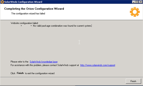

Configuration Wizard Error: No valid package combination was found for current system
This article addresses the following configuration wizard error: No valid package combination was found for current system. This error typically occurs when running configuration wizard on Additional Pooling Engines or Additional Web Servers (Scalebailty engines)
10/12/2018 5:21 PM
10/5/2023 9:55 AM
The configuration wizard fails with the following error(s) on multiple pollers. The error could be different depending on which package is failing but the common message is "Cannot find no valid combination for current system"
2017-05-25 13:50:32,331 [17] INFO PackageManager - Cannot find no valid combination for current system. 2017-05-25 13:50:32,331 [17] ERROR ConfigurationProgressScene - Exception while configuring plugins. System.Exception: No valid package combination was found for current system. at SolarWinds.Packaging.Core.PackageManager.UpdateSystemInternal(UpdateSystemContext updateSystemContext, Boolean checkChangesOnly) at SolarWinds.ConfigurationWizard.Common.Packaging.PackagingExecutor.UpdateSystem(IHostInfo hostInfo) at SolarWinds.ConfigurationWizard.Host.Presentation.CommonConfiguration.ConfigurationProgressScene.DoConfigInThreadUnsafe_DeployPackages(IOrionConfigHost host, PackagingExecutor packaging) at SolarWinds.ConfigurationWizard.Host.Presentation.CommonConfiguration.ConfigurationProgressScene.DoConfigInThreadUnsafe(IOrionConfigHost host) at SolarWinds.ConfigurationWizard.Host.Presentation.CommonConfiguration.ConfigurationProgressScene.DoConfigInThread() 2017-05-25 13:50:32,331 [1] INFO OipClient - Tracking event: ConfigurationWizard - ConfigurationProgressScene - UpdateFailureText: • • No valid package combination was found for current system.
