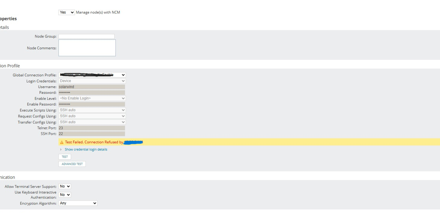

This article provides information for the "No matching mac found" error in the switch logs, which is caused by the SSH Communication. Also, sometimes the switch/node gives the following error: Test Failed. Connection Refused by X.X.X.X
For connection failures, refer to NCM error: Test failed. Connection refused by x.x.x.x.
If that doesn't resolve the issue, check the logs from the switch side. There, we can observe something blocking the SSH communications.
