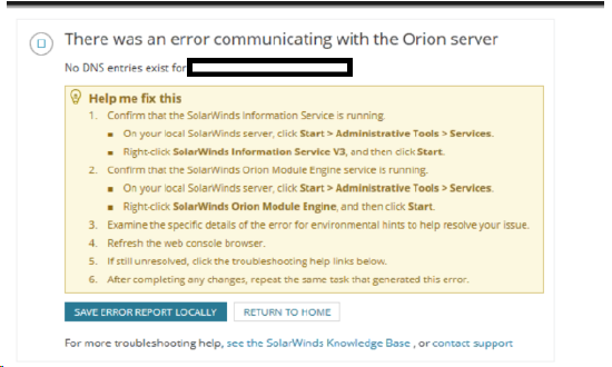

The following error appears when trying to edit an interface for any device that is assigned to an additional poller:
There was an error communicating with the Orion server. No DNS entries exist for hostname.example.ex.
