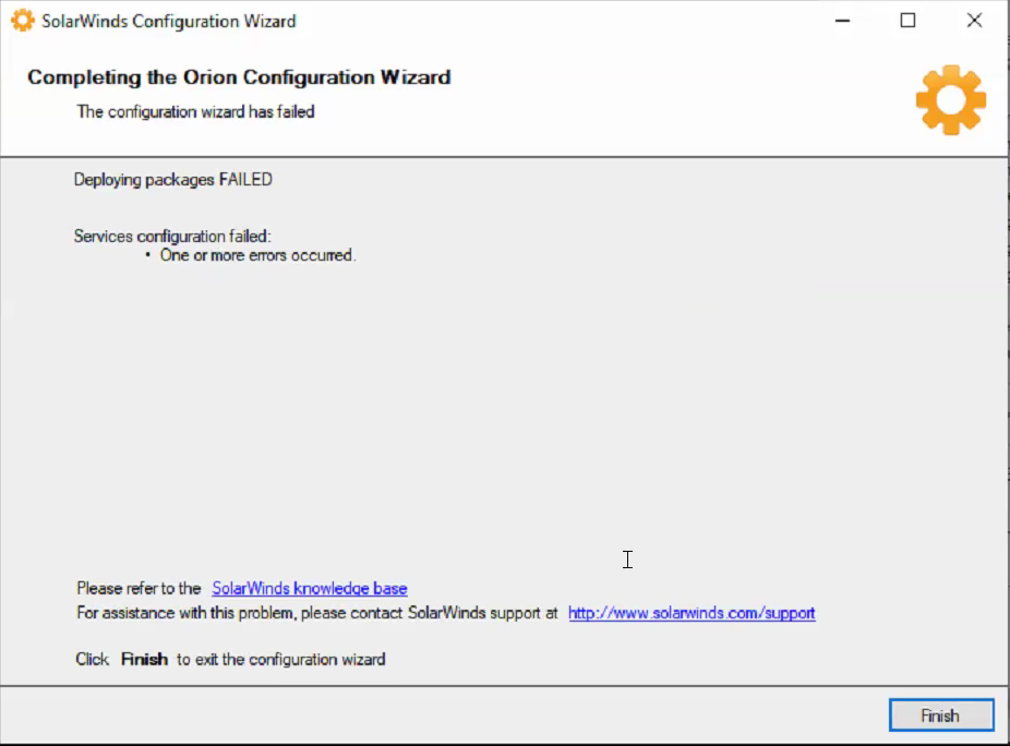

New Install Orion Platform Deployment getting Configuration Wizard Fails: Deploying packages FAILED. Services Configuration failed: one or more errors occurred
This article shows resolution to the most common Configuration Wizard error after installing the Orion Platform.
4/28/2020 1:34 AM
6/27/2021 8:30 PM
After the Orion Platform Deployment install, the Configuration Wizard will need to be completed. During the process it runs into a failure similar below:

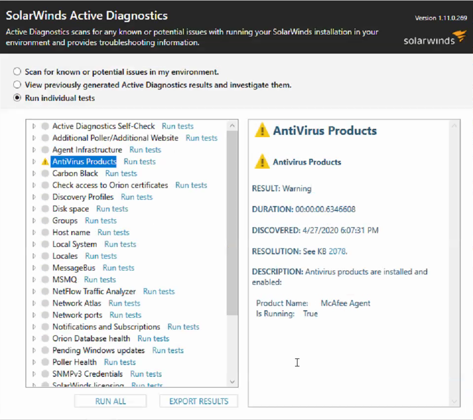

An Anti-virus is currently installed and enabled on the server impeding the deployment of packages. This can be verified and confirmed by using the SolarWinds Active Diagnostics:
  1. Disable the Anti-virus software
  2. Reboot the server
  3. Re-run the Configuration Wizard
