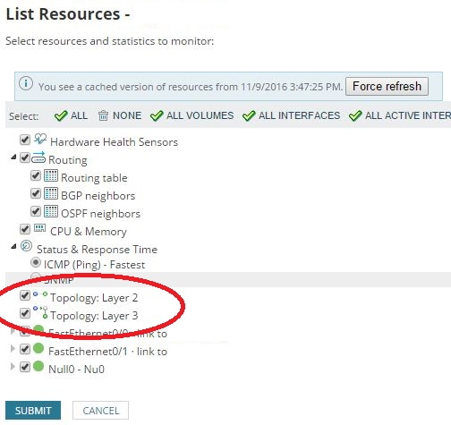

Core routers or L3 switches that contain thousands of host records in ARP and CAM can slow down the topology calculation and may impact these devices when polling. When there are performance issues during topology polling (every 30 minutes by default), it is recommended that you disable topology polling for the affected device.
Topology polling can be disabled from the List Resources dialog:
