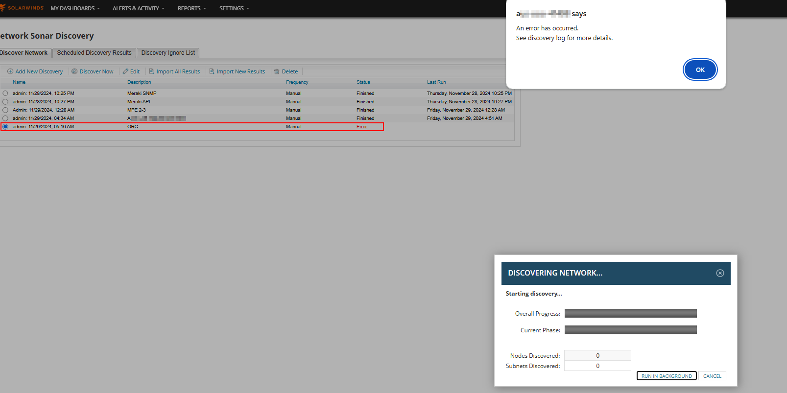

When you deploy a Collector with an existing Agent node and configure a network discovery, you may find that the discovery fails to complete, and shows an Error under Status on the page at Settings > Network Discovery:
Errors can also be seen in the log at C:\ProgramData\SolarWinds\Discovery Engine\OrionDiscoveryJob.log.
