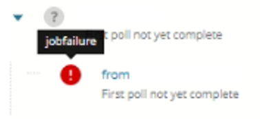

You have deployed a Netpath Probe either from main poller or additional poller and see below message on the netpath. You have confirmed required netpath requirements have been fulfilled and no firewall issues when performed traceroute test and tcp ping test.
