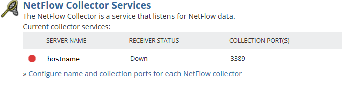

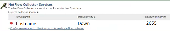

When the Netflow Receiver service is down, Netflow Collector Services in the NTA Settings page displays a down server hostname, as shown below:
