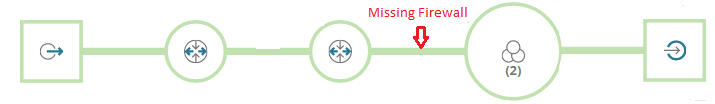

The NetPath graph seems to be missing a firewall.
The expected firewall node is missing in all NetPath graphs, or it is replaced by the next node device of the firewall.
