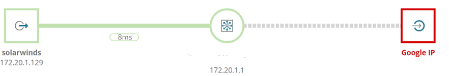

NetPath graph issue: Missing Internet nodes, where connection stops at internal node
Steps to verify when the endpoint cannot be reached in NetPath
The NetPath graph seems to be missing Internet nodes.
NetPath traces constantly end at internal intermediate nodes. The issue happens to external endpoints only. The issue happens to all web traffic, such as HTTP, HTTPS, well-known ports, and alternative ports. Normal application traffic can reach the endpoint without issue.
