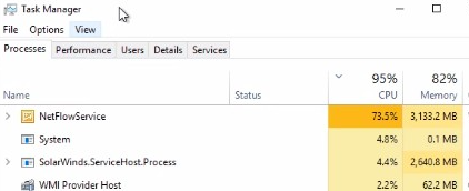

  1. Open Task Manager on the affected polling engine and sort by CPU. NetFlowService.exe will typically appear as the top consumer, often utilizing 60% or more of available CPU.
