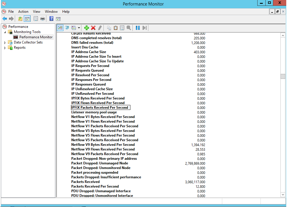

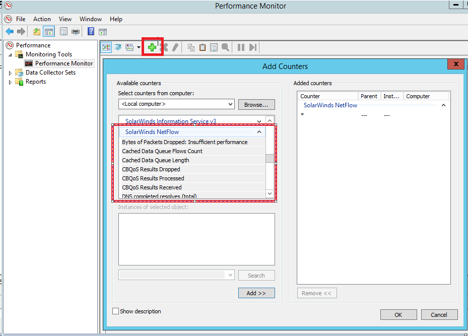

NTA Data Not Available, but Flows are showing in Wireshark, but not in Performance Monitor
- Run Performance Monitor on the server and load the Netflow counters:
- Select the view to Report and you should see packets coming in for Netflow:
- If nothing displays here and you can see flows are coming into Wireshark and the packets have the required fields, then the Firewall on the server is likely turned on.
- Verify on NTA events if you see the following:
Windows FireWall is turned on and its current exceptions do not allow the NetFlow Service to receive packets. Run the Configuration wizard for ‘Services’ to remedy. - Either turn off the firewall or create a Firewall inbound rule to allow traffic for the port that is being used to listen to ex: 2055.
